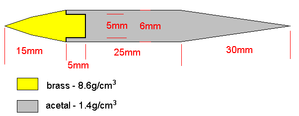

Now that I have my own machining facilities I was thinking of giving this a go myself.
Anyone with CAD facilities care to determine the CG and CP of this design?

Here's a quick inventor sketch (threaded with m5x0.8 )

Any particular length/angle for the brass cones?
CG would be roughly 20.2mm from the tip. (with an estimate dual cone angle)
How are people estimating the CP ?
Centroid of section along the longitudinal axis is ~31mm from tip, seems that some rocket people use that...

jackssmirkingrevenge wrote:Anyone with CAD facilities care to determine the CG and CP of this design?
I'll make a stab at it, but it'll be another 6-7 hours before I can get to it. If you don't have an answer by then....I'll do it.

al-xg wrote:Mmm, yeah how are these projectiles retrieved ??
Assuming they are built in the same manner as the first post with two endcaps push fit in a tube, there's plenty of room to house a recovery mechanism. I'm envisioning a spring loaded or pyrotechnic device that pops the tail off on impact with the ground, releasing a foil/mylar streamer that will be highly visible in good sunlight even from large distances., especially with a slight breeze blowing.
What I drew is a small scale version, a "wind tunnel model" if you like.
Not really, can be a straight taper.
Right... you do realise that cad drawings don't have to be small to fit on the screen ? ;) :P

I drew it small scale because it's roughly the dimesions I intent to build it to, for testing from a 6mm pneumatic ;)
