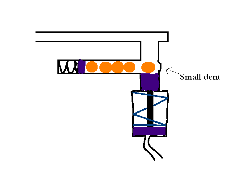

The bb's coming out of the mag on their own is easily solved:
- A small dent opposite to the magazine.
- MagDent.PNG (14.81 KiB) Viewed 3487 times

You should probably have a detent to keep your BBs from rolling out the barrel if you aim downward, and also, why not just use a commercial factory made air cylinder? They come in every size imaginable

One spring in the magazine will only feed about 6 BBs.
Do you plan on multiple springs and how do you plan to hold the springs together?

This is hooked up like POLAND_SPUDS semi
I see some animations are in order
Mag spring wise, I have a bench grinder, so even if I didn't buy them closed and ground flat, I can grind them myself. I plan on stacking 4 in the mag.
I guess I've been more unclear about my design than I think I have. As my paintball tank fills my QEV, it also charges the air cylinder which is emptied into the barrel as the QEV fires.
As for the bb being pushed from the mag to under the loading piston, even if this happens it will be trapped between the edge of the mag and the loading piston stick, the bottom of my loading piston will be conical so it pushes the bb back into the mag. Remember my mag spring(s) aren't very strong.

I will have a detent, not shown in this diagram.Lockednloaded wrote:You should probably have a detent to keep your BBs from rolling out the barrel if you aim downward

I find it funny how I pulled that animated design from the picture posted by PotatoEnemy17 at the top of this page without reading any other part of this thread.
That would probably work nicely though. The chamber pressure acting on the air cylinder could even be used as somewhat of a detent if done right.

Hmm I never thought of it being used as a detent, that's clever, though I already have a detent. (mcmaster #1368A11)
