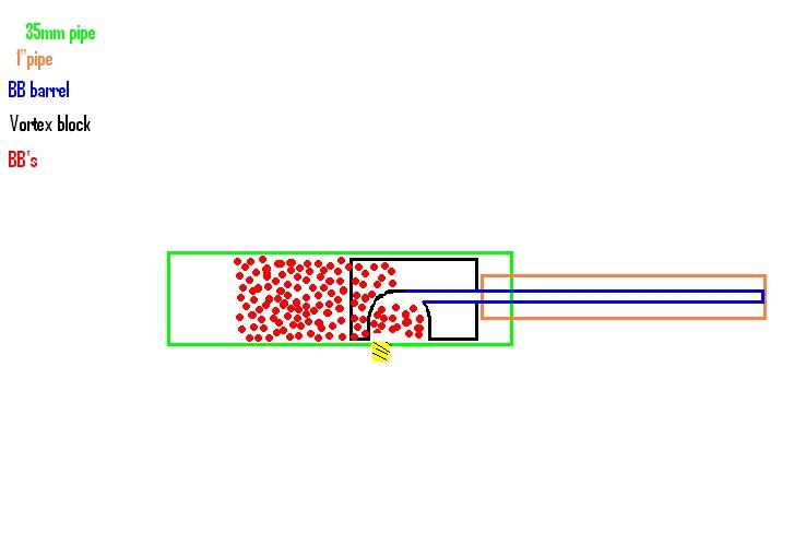

im gonna have a 1" barrel, with my bb barrel inside that... this is kind of a diagram how i think it thould be?

That would work fine, although I'd make a couple of small changes:
Put the nipple back farther, right where the curve of the block starts.
Keep the nipple flush or below the inside of the pipe wall.
I edited your diagram with the changes I suggested.

Wow these actually make sense to me now...... i gotta make one of these!

yeah, ive only just realised hwo they work, now i feel so stupid because they are sooooo simple! thanks for that touch up noname, you've helped me alot.

is there really a big difference in an ain-line vortx bolck than the regular full circle. I recently made a regular block is it worth upgrading to the in-line?

do you mean the full cirlce for vortex hole? if you do, then from what i've heard i would upgrade to the inline one because if you have a whole cirlce, the bbs have to go around more to get out the barrel, using more air. but the inlines only have 3/4 of the hole, meaning less are to cover before they get to the barrel, means more air efficient

Wow thats true, totaly understand how they work now due to Mr.Russ diagram, sweet im gunna make my self one of them in my new gun im planning :) Cheers
