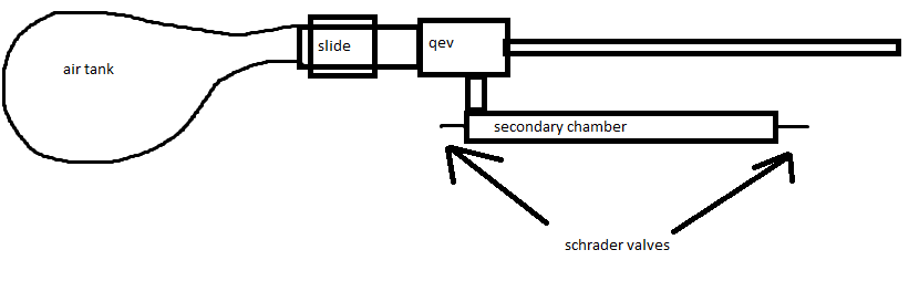

Tue Nov 29, 2011 3:17 am
Question: Is it possible to set up the system as shown? By this I mean look at the placement of the schrader valves (this just makes the construction process slightly easier, whereas if not possible, i'll just use a 4way junction between the slide and air tank.)[/img][/b]
Crna Legija
Posts: 2333
Location: australia
Tue Nov 29, 2011 4:23 am
Not will a stander QEV you will need to put a small hole 1mm or less i would say and a weak spring behind the piston then it will work.
