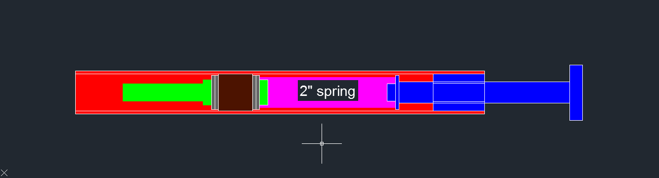

Here is my design for a hammer with an adjustable hammer weight and spring tensioner.
Excuse the flamboyant coloring :D
Red is 1/2" copper
from left to right
green:1/4" bolt
gray:1/2" washers
brown:wood with same ID as pipe
pink: spring
blue: 5/16" bolt and washer and coupling nut to adjust spring tention.
The excess green bolt will go through a nylon spacer that has a machine screw coming out the side to function as a bolt handle to pull back the spring (the machine screw will obviously come out a slot cut in the copper). I want to use the charging sleeve so that the screw coming out the side does not shoot forward upon firing, I can simple slide it back forward after I engage the hammer to the sear.
Not pictured: trigger/sear, charging sleeve (nylon spacer) and handle.
So I can tention the spring with the bolt, and adjust the hammer weight by adding washers. The left side of the bolt passes through the charging sleeve and hits the valve.
Thoughts? Improvements?
Also, where on the pipe would be optimal for me to position the sear?
(drawing not completely to scale-- I estimated some lengths so its a bit whack)

Gun Freak,
Striker travel should be 3/4" - 1 1/2" before contacting the valve stem. Would stay on the long side of this for a first time. You can always lengthen the striker to reduce effective stroke at a later time.
With your spring of choice, and adjuster screwed all the way in, you should "just" not be able to engage the sear. Back off the adjuster a 1/4 turn, and you should "just" be able to engage the sear. This will maximize your adjustable range.
Can use a spring guide on the striker side of things to increase effective striker mass if needed.
Striker bearing length should be no less than 1.5x diameter...more is better here as it will "run" smoother with less binding (greater consistency). Find something other than wood if you can.
Add a "locked" position to your slot in the aft position to provide a rudimentary safety without adding to parts count. :)

@Gippeto, thank you for the help! Drawing will be ammended after school.
