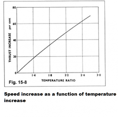

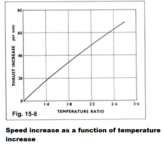

What I think is that you can significantly increase the speed of the air coming out of the pressure tank, heating it. It's like an afterburner. The increase in flow velocity depends only, in general terms, on the initial and final temperature relationship.
For example, if the air leaves a tank at 7 bar, and has a speed of 120 m / s when expanding in the barrel, with a temperature of 20 ºC, Ti, (293ºK for the calculation because it is absolute temperature), and we heat that air with a fuel at 1500ºC, Tf, (1773ºK), as in a hybrid but continuously, the final speed will be the square root of Tf / Ti, which as a result gives 2.45. The speed of the superheated air would increase approximately in this percentage, 245%, about 294 m / s ... It works the same as an afterburner. For the rest, first idea, it is only necessary to interrupt the air outlet and combustion process with a trigger. It is somewhat of a hybrid because it uses compressed air and a fuel, and it could be a burst weapon.
The increment is as in the drawing, taken from a jet engine article.

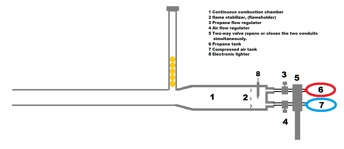

It goes something like this roughly
Afterburner BBMAG.png (18.29 KiB) Viewed 182839 times
The gun trigger activates and deactivates the main valve and the ignition simultaneously. The flame holders are for the flame to anchor in that area because if there is not, everything can go out without control.
The device only gives more speed to the compressed air that comes out of the tank. The propane gas flow regulator adjusts the necessary amount, and the air flow regulator, I think it is not necessary. By simply varying the amount of gas and keeping the amount of air flowing per unit time constant, a stoichiometric mixing can be achieved.
The bbs, would be sucked by the gases that pass very fast through the nozzle. I don't know how hot the bbs will get, because the time it is exposed to intense heat is very short. This is a first approximation to the BBMAG afterburner.

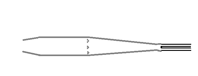

The problem is that the speed of the air leaving the tank does not decrease, or decreases as little as possible. In the drawing, the increase in area and shape make the air slow down ...
I think that if the area is increased as little as possible and with a truncated cone subsonic diffuser shape, the losses would be less. Another problem is that it is quite difficult to maintain stable combustion if the air is traveling at high speed. The shape of the combustion chamber could be like this ...
cámara combustión BBMAG afterburner.png (1.72 KiB) Viewed 182838 times
Another factor that improves everything is the length of the chamber because it increases the time the air has to heat up. This is just a thought of mine, I don't know if it's practical or if it will work. Maybe in the future I will try, or I don't know.
