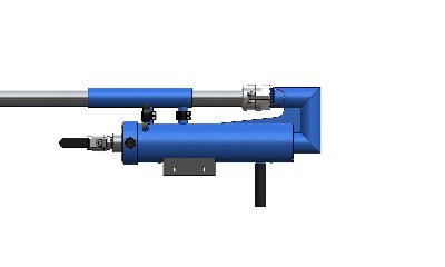

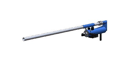

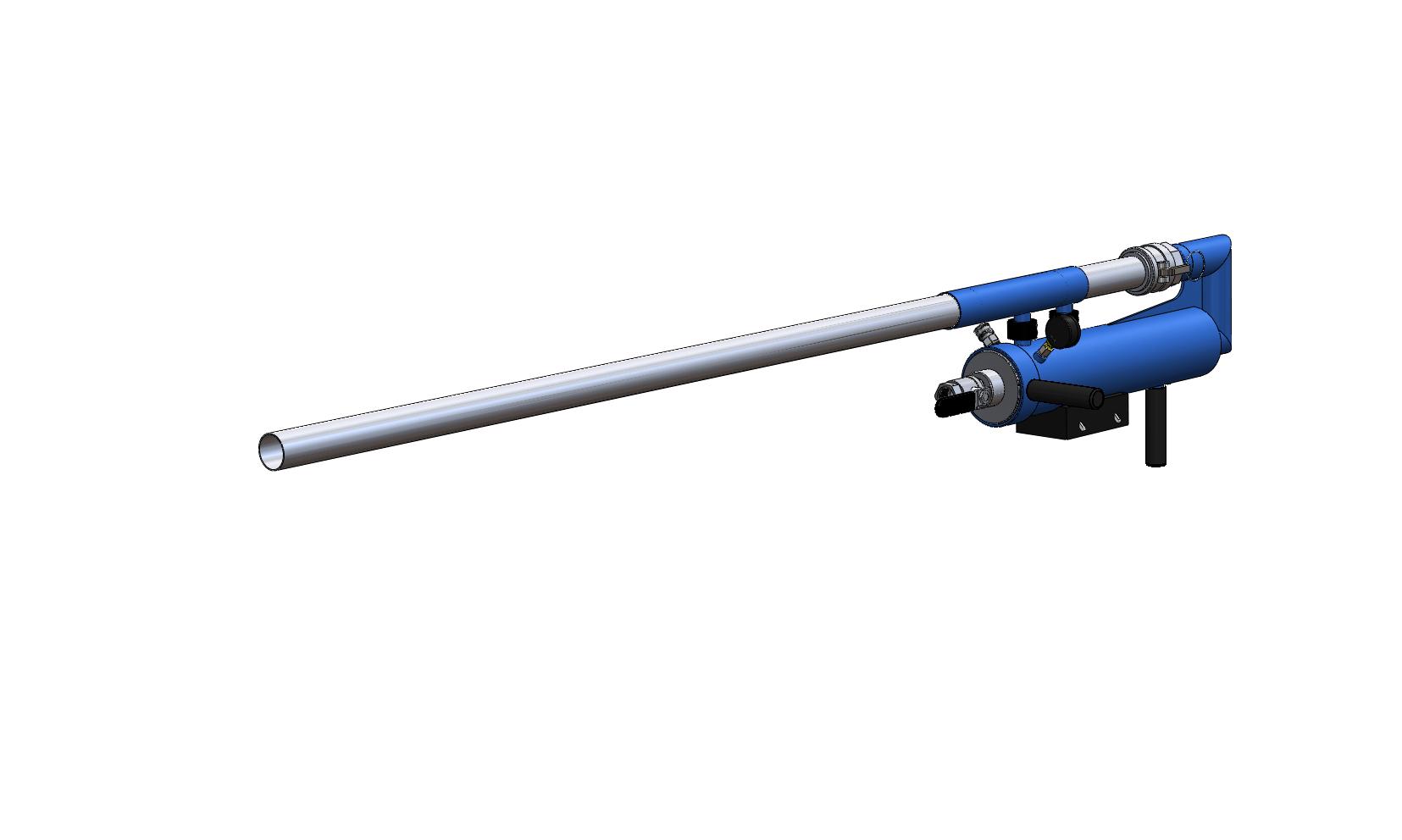

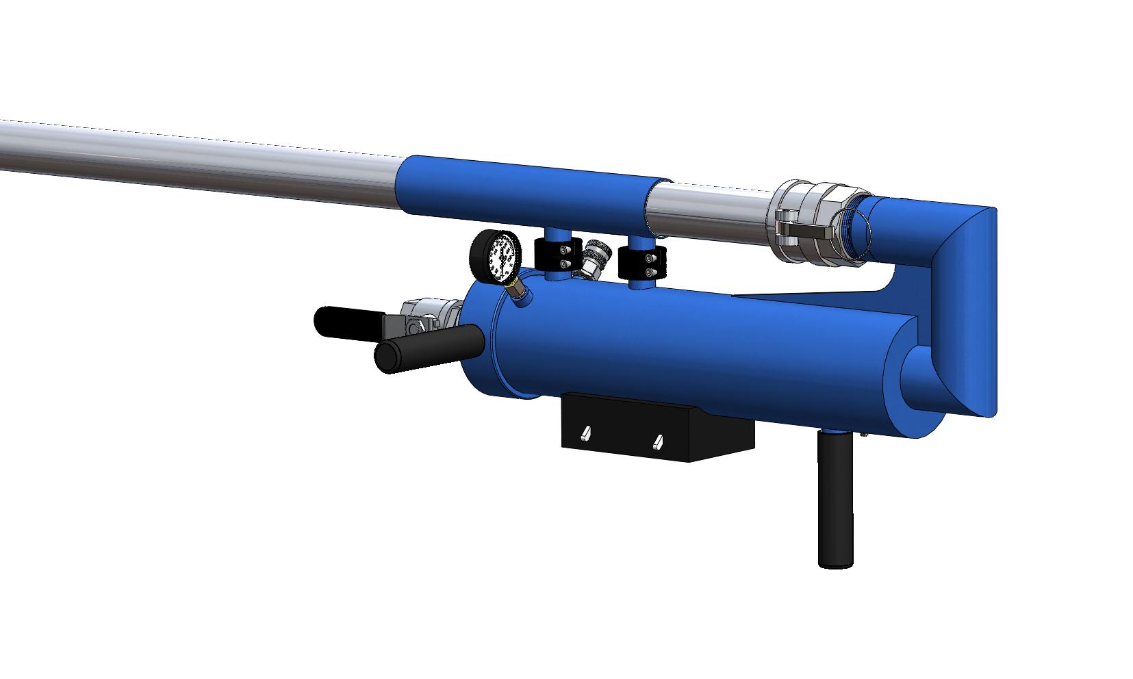

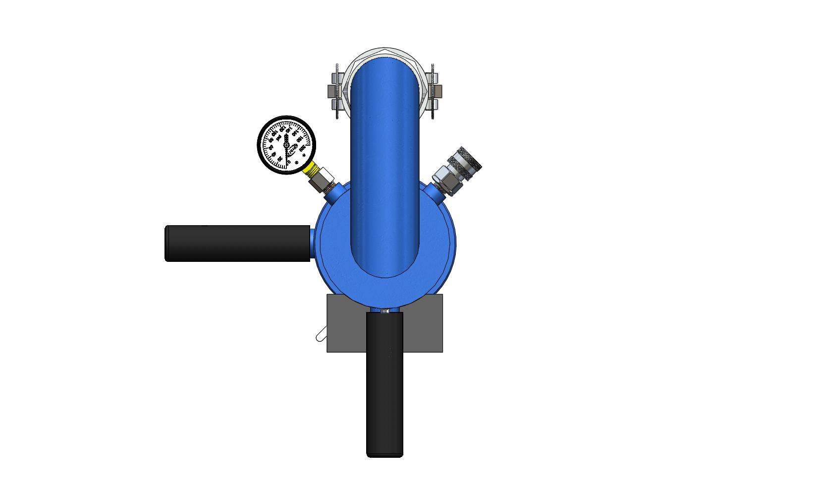

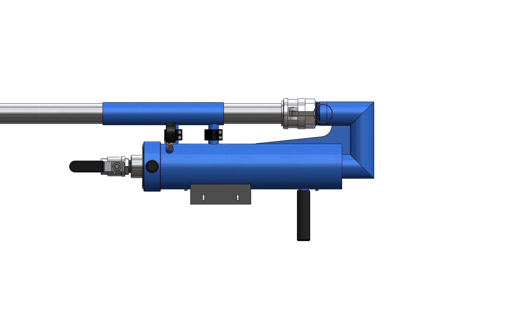

Design Update.
Thanks for all your input. I have made the following changes. First of all, I changed the chamber wall thickness to 3/16" from 1/8" due to strength loss from the holes in the chamber. I made the gusset larger. It extends half way across the chamber, transmitting all the recoil. If you held the cannon vertical, you could hang 800lbs from the rear end where the barrel starts with a factor of safety of 3.7. If anything breaks from recoil, its going to be me.
I added a small orifice flow control adapter, rather than a needle valve to protect the gauge. It was the smallest orifice McMaster had (2822T189).
I changed gauge and inlet locations. I got rid of all pipe clamps and used wide shaft collars to connect the barrel support to the chamber. I shortened the chamber by 2" because the volume was enormous and ridiculous.
The long gusset got in the way of the spark strip screws so I placed the screws on the bottom of the chamber, out of sight. I will be making myself a custom plexi box that either connects with stainless clips by using the spark strip screws for mounting, or a separate plexi mount plate attached with hi strength, yet removable and in no way permanent modelling glue (excellent stuff, I use it a lot). Its a strong rubber cement/sealer.
Current total weight: 16.5lbs. If you guys have any other comments or suggestions, I am all ears, however, I ordered the material today, so nothing TOO major can change. THANKS!
EDIT: Oh! I almost forgot....she has a name. "The Scorpion"

Oh yeah!! Looking good Moon. There's only one thing I can think of at the moment...just to be aware of. You're going to have access to your chamber from only one end so unless you have really really thin hands and arms, getting to the rear spark strip mount to screw it down is going to be a real challenge.
Just be thinking about how you're going to tie it down in the rear.

My hand can fit in there. I did a little mock test and it will be OK. Good eye though. A lot of people don't think about stuff like assembly etc. I really wanted to use a smaller chamber to have the whole thing be really sleek and streamlined looking, but there was no way my arm was getting in the back of a 3" pipe lol.starman wrote:Oh yeah!! Looking good Moon. There's only one thing I can think of at the moment...just to be aware of. You're going to have access to your chamber from only one end so unless you have really really thin hands and arms, getting to the rear spark strip mount to screw it down is going to be a real challenge.
