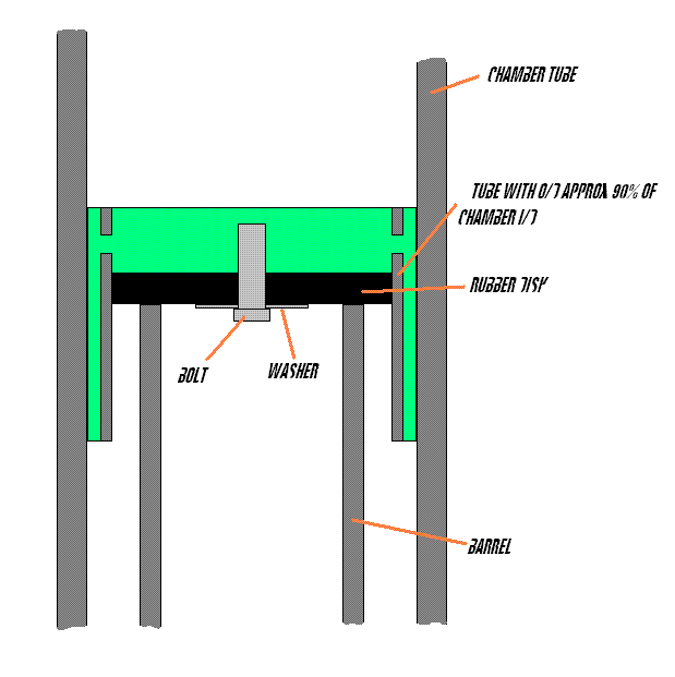

Tue Mar 04, 2008 10:01 am
The technique does lend itself more to smaller pistons, however with a bit of ingeniuty and common sense it can be adapted on a larger scale without a corresponding increase in cost and weight. I would go with something like the design illustrated below (assuming it's for a coaxial design) that gives you a piston long enough for stability but which makes minimum use of epoxy making it relatively cheap and light, and also gives you a flat piston base meaning no unnecessary pilot volume is added.
Jared Haehnel wrote:... and whats the cost of the epoxy?
Going by this advert, a mere 20 bucks will get you 32oz of the stuff, not exactly prohibitive costs.

Tue Mar 04, 2008 10:24 am
Jared Haehnel wrote:I'm guessing Bondo is out then....darn
Definitely, you can't cast with a putty :p but the one I linked to is more than suitable and for less than 20 dollars won't break the bank.
