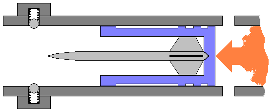

Would porting the end of the barrel help with accuracy? That way the sabot should be slowing down and separating from the projectile while they maintain their axis because they are still in the barrel.
Mon Apr 25, 2011 1:16 pm
the unit wrote:Would porting the end of the barrel help with accuracy? That way the sabot should be slowing down and separating from the projectile while they maintain their axis because they are still in the barrel.
I don't think porting will have that effect. What could be done, if one had the tools and materials, is choke the end of the barrel in such a manner that the sabot encounters friction at the muzzle, slowing it down before exiting.

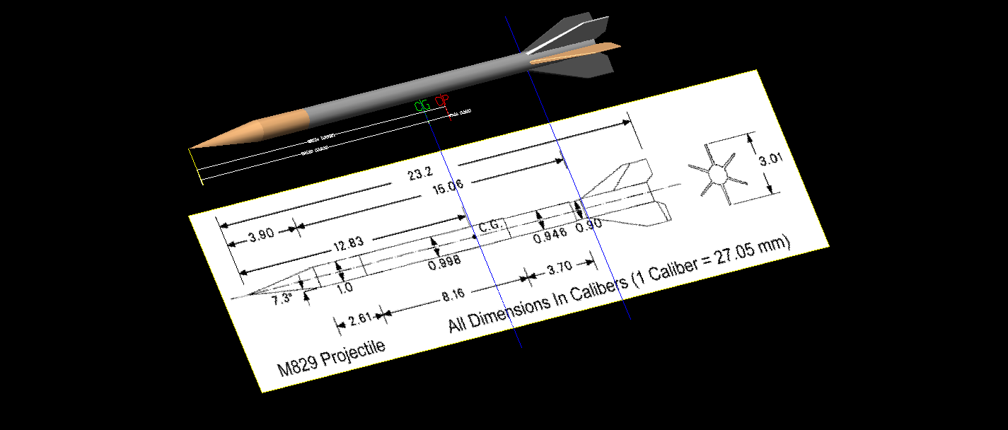

Just for JSR and his military projectiles.
If any one wants a CAD file just PM me!
edit for: any one wants

dewey-1 wrote:Just for JSR and his military projectiles.
Beautiful Duane, makes me want to deplete some uranium!

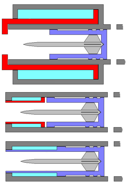

ramses wrote:Without touching the fins. As far as supporting the nose of the projectile, a flower pedal sabot would be useful there. It wouldn't see much force or pressure, so it could probably even be styrofoam or similar. This would interfere with the choke, though.
Here's another variation of what I had in mind, the idea is not to stop the sabot, but slow it down enough for the projectile to slip free before the sabot leaves the barrel. With sufficient porting as the unit suggested, it might just work.

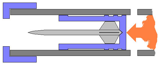

A variation of the idea, maybe more feasible to build quickly, without over-engineering the barrel muzzle (please note that I didn't say that I didn't like that :D )
The shock from the sabot to the end cap slow it down and set the projectile free.
Of course a bit of friction/tape/whatever (except epoxy) to hold the cap tight might help.

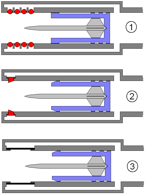

I don't think porting alone with work, because if the friction on the sabot isn't dramatic to some extent, sabot & projectile will likely stick together and slow down as a system. In this case I think LeMaudit's idea is a valid one.
The ported gas can be put to work though as per the concepts below, by pressurising a space at the muzzle that then:
1) pushes on a series of ball detents
2) pushes on pistons
3) pushing on an annular diaphragm

... on to his previous idea, it might be possible to stop the sabot without destroying both sabot and launcher by forming an air cushion. Here are several configurations that might work with the air cushion area denoted in cyan. The last one is the simplest as the sabot itself forms the air cushion and in practice would probably mean that sabot and muzzle plug never actually physically touch.
