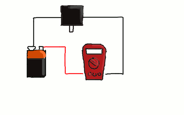

You're trying to do this? That's what it should look like
The meter polarity is not important. If you hook it up backwards it'll just read negative current.

Yep that's how I'm doing it. The motor doesn't run. It's like the meter is messing up the circuit.

Ah, ok I tried changing the positive lead from the meter to the port in the middle and I got a reading of -.62. So... What exactly does this mean?
