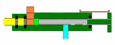

Where the air input is blocked off. I assume you used an oring or something to seal the whole system when the pipe is still in the backwards postition. You were talking about some leaking, but not too much> that sounds pretty nice.
Wed Mar 26, 2008 10:50 am
No seals at all, it's just a tight fit ;)
Antonio
Posts: 508
Wed Mar 26, 2008 10:54 am
From my experience it is hard to get a tight fit when using metals. But yeah k, I guess you are ganna fix the leak though right? What are you thinking of?>
Wed Mar 26, 2008 11:04 am
ant wrote:From my experience it is hard to get a tight fit when using metals.
Metals only, yes, but when you're casting the epoxy around the metal component, the fit is very tight. Not leakproof, of course, but leaks are negligible.

I hope this idea didn't die with this thread... I have an idea!
The bolt will not blow back on it's own because there is no force acting on, well not enough. So why not add a detent so the ammo stays in the barrel longer, air pressure builds, and the rod blows back!

this might work at higher pressures
remember BtB's pnushnikov and all that crxx about having delayed blowback ?
well guess why it was delayed?
(becasue it might work on its own... you just need to use larger bore and higher pressures than JSR)

Lockednloaded wrote:why not add a detent so the ammo stays in the barrel longer, air pressure builds, and the rod blows back!
I had tried this (rather obvious ;P) solution with flared out 0.22 pellets, effectively acting like a detent, and no success. At 100 psi there was simply too much friction. Granted, now I have 8 times that to play with, but that now means that a simple BBMG is good enough :D
because it might work on its own... you just need to use larger bore and higher pressures than JSR
What I don't like about the design is that it is fundamentally flawed, in that the valve starts to close and breech starts to open at the moment of firing, it will be quite a balancing act to get it together and working well.
Wed May 05, 2010 7:07 am
well I didn't say that your design is flawless... but that the blowback can work
anyway I think you just have to modify your original design... if you have a look at it it isn't that bad...
...add a DCV or an aircylinder here and there and it might work :D

You know, if this turns out to be practical, with some modifications you might have a point about this design working at higher pressures...
Fri Jul 16, 2010 6:40 am
I see that you realized that it would be good to have a mechanism that closes off air supply when the gun fires :D
Sat Jul 17, 2010 6:58 am
It's more the idea that one of the inconveniences of the valveless/popoff concept is a pressurised magazine. Not that I've given up on that though, ordered a tube bending set ;)
