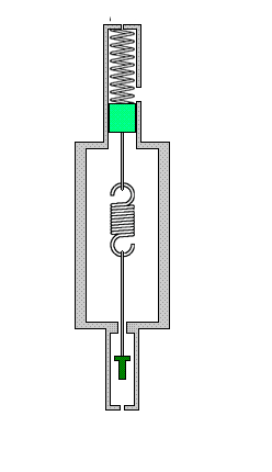

Ahhh, I see, all is clear (I found my old "Revise O-level Physics" book.
On JSR's latest version of this a way round the "farting" would be to have a spring between the two movable seals, so that the inlet could seal before the high pressure inside the chamber opened the outlet. Like so:

No I don't think the valve would lock up at that point, it might if you had it looking exactly like it is in my picture, with a loose tension spring, but that wouldn't actuallly be the idea. The simplest would be to use a long tension spring and bend it to form the whole of the connecting rod. Of course it could be modded with two tension springs pulling rather than the one pulling and the compression spring pushing.
The one concern I'd have with any version which relied on sliding pistons so much would be the sealing and the lubrication. To seal well it needs to be a tight fit, but too tight and it won't slide easily. That's why I prefered JSR's version (but with the spring in between).
