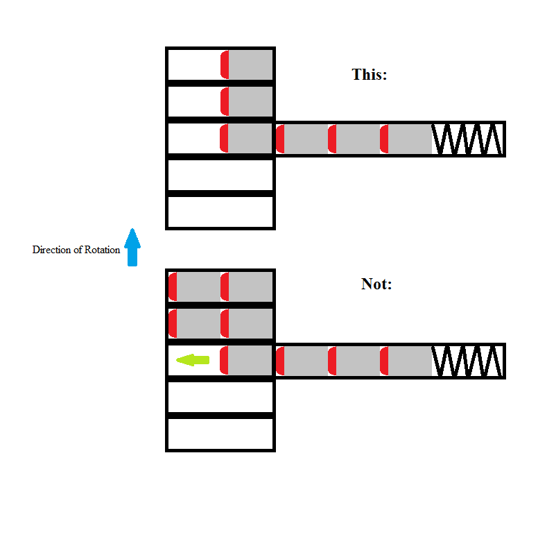

How were you thinking of reloading automatically? A gravity mag and solenoid, pushing darts into the barrels as they spin?
And then what's the point of having 15 barrels? A gravity mag and 2-3 would work just as well.
And what do you mean by the last sentence? That the darts would only fill the front couple inches?
- Staff Sergeant 3
- Posts: 1762
- Location: United States
Somewhere on the side of the side of the gun would be a spring loaded inline magazine which (at some point) lines up with the empty barrels as they go around and inserts a new dart into them. Yes, if I've done that, I might as well have fewer barrels.
The trouble with having such a loading system is that you'd have to devise a way to insert just one dart into each barrel for every pass. If the barrels are 4 inches long and the darts are 2 inches long, the mag will try to fill the barrel with 2 darts assuming a detent is placed at the end of the barrel.
