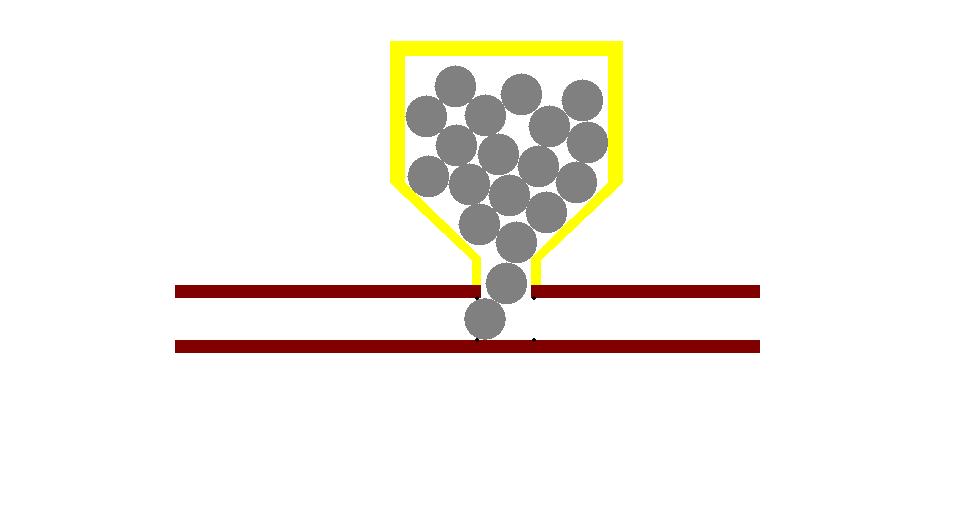

hey guys new Q
Im thinking of making a semi auto airsoft gun with a simple T mag. I had an Idea that If i make a little hole at the top of the mag so when I shoot one bb the rest in the mag get sucked up the mag until the air is cut off then they fall back down and the cycle repeats...
tiny hole drilled here at the top
knvnkjdnkj./\
knvnkjdnkj|o|
knvnkjdnkj|o|
knvnkjdnkj|o|
knvnkjdnkj|o|
knvnkjdnkj|o|
--------------o------------
ya you get the point. :D I figured that This would waste about the same amount of air as a simple blowback system. so any way, would this work?
Mr.Tallahassee
Posts: 364
Thu Oct 20, 2011 11:33 am
It would work if the airsoft BBs were a fairly tight fit in the mag but you couldn't have more than a few dozen shots without a very long mag. I wouldn't worry about pushing the BBs up into the mag so much because even when the mag is sealed the pressure pushes them up. I would say use a small detent in front of and behind where the mag attaches to keep the BB from rolling out.

wyz2285
Austria
Posts: 2388
Location: Porto, Portugal
Thu Oct 20, 2011 12:53 pm
there will be double feed, when the air pass from the barrel, it creates a vacuum efecte witch sucks the bbs from the mag to barrel
pneumaticcannons
Posts: 392
Thu Oct 20, 2011 10:13 pm
hmm youre right wyz2285 I forgot about the Venturi effect so unless the burst of air lasts > or = to the amount of time the bb takes to exit the barrel It would just suck more in... i guess ill just take Mr.Tallahasse's advise and make a small hopper hopping the pressure will push the bb's up even with a sealed mag.
