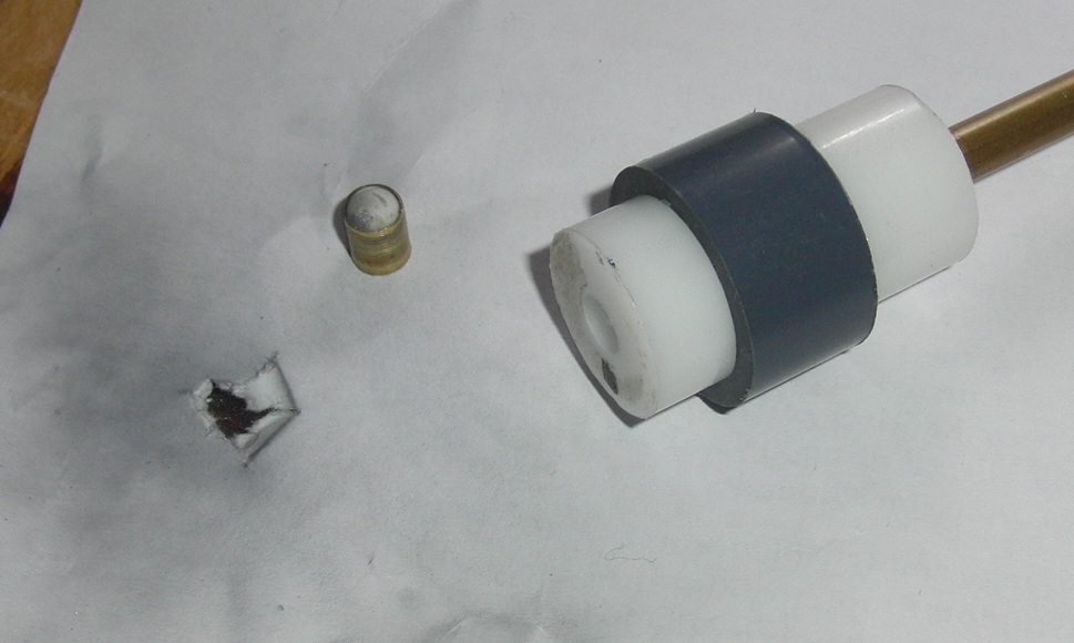

Hybrid test at 8x, fail. The BB lodged in the insert tube and blew it out. Clearly I'm going about this the wrong way in terms of the usual underengineering, as well as not incorporating an expansion chamber in order to lower stress on the BB.
Looking at the high speed footage though, I have one niggling doubt. I filmed it originally at 420 fps and then slowed it down even further:
You can definitely see something going into the hole after the paper is blown away, and to me it looks much more like a lead pellet than a brass tube with a BB embedded it. As well as that, the pellet simply bounced off the wooden backstop so nowhere near the penetration I would have expected.
I'm forced to conclude that the BB/tube combination blew out before the pellet. Thoughts?
Here's the aftermath, note the discolouration on the paper:
If that happened, it´s obvious that the bb is blew out.
Maybe because the barrel isn´t tight enough comparing to the lead pellet, also the pellet maybe too heave and a considerable quantity of gas were able to passed though it and shut-off the suppressor.
Possible.
So far we have learned that it needs to be stronger or the pressure acting on it should be lowered.
We won't know if it's any good unless you add an expansion chamber to it.

A major problem I'm seeing aside from the strength of the system is that the exit hole is identical to projectile diameter, and there is only 0.5mm difference between ball and projectile.
I'm thinking the next step should be a smaller diameter version, say 3 or 4.5mm, if I'm stuck with a 6mm BB as a blocker.

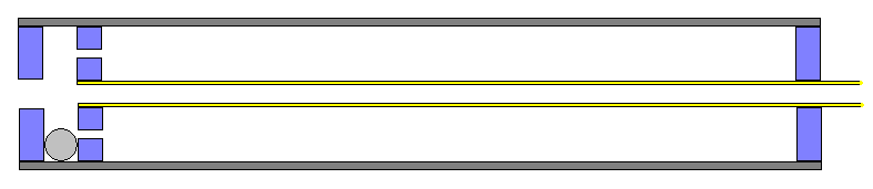

Here's what the current prototype looks like inside, with a 5.5mm barrel, 8mm ball bearing blocker and 7mm muzzle opening. Instead of being in a tube, the ball rests between the two front baffles like this.
Tue Feb 28, 2012 2:45 pm
No joy with this one, as suspected the heavy steel bearing wasn't picked up by the gasses...
I'm calling this one plausible, but it needs tweaking.
