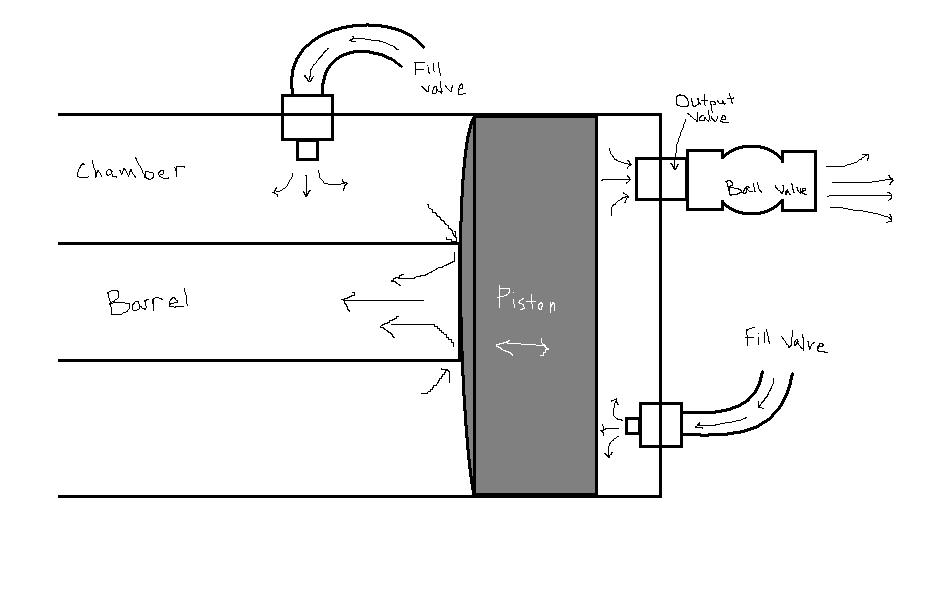

yeah, thats a coax, i drew you up a diagram myself to help you better understand the concept, hope it helps (i gotta eat supper so wont be back on for 30 mins)

Wait.. I didn't know you need another fill valve leading to the chamber. I thought that at first but then I read that the air leaks around the piston.

STHORNE
Posts: 1208
Location: Kewaunee, Wisconsin
Mon Mar 10, 2008 6:35 pm
yeah, theres two methods, the leak method and the 2 fill up method, either one works. but you dont usually have air leak all around the piston, you just have air leak through a hole in the piston, but either way, it'll work.

Yah I like the leak method, seems cleaner. I know there should be exhaust holes but how do I make them?

Mon Mar 10, 2008 7:13 pm
with a drill. use between 3/16 and 1/4" drill bit.

I think you misunderstood or I am being an idiot agin.. When I said exhaust I meant the wholes for the air to leak into the chamber.. Wouldn't those wholes be too big and would let the air "flow" rather then leak.

Do you mean equilization holes in the piston?
if you do you dont need them unless the piston has o-rings because it wont be anywhere near airtight without orings and the air will freely fill the chamber.

yeah, he means equalization holes. and i tried telling him if he uses o-ring then he needs the hole and vise-versa. but w/e, i give up (no offense Counterstriker)

bigbob12345 wrote:Do you mean equilization holes in the piston?
I can't understand your question.. sorry but.. I am a flaming idiot.. I understand almost all of the steps on making it, just not the park of "leaking air" and o-rings..
bigbob12345
Posts: 1516
Mon Mar 10, 2008 7:30 pm
okay just make a piston valve without orings or equalization holes and you should be fine.
