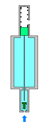

Fair points, how about this then?
- autopistonv3point2.GIF (4.06 KiB) Viewed 4601 times

Actually with HotWired's design, as soon as the spring returns the top piston down and the bottom piston moves down with it, for the air to seep past...
Wont it just push the top piston back up which will move the bottom piston up blocking the air flow and minimizing the air pressure inside of the chamber
As soon as a tiny amount of air is in the chamber it will block of the air flow as the pistons move up.
What I don't like about hotwired's design is the fact that it's got two coaxial pistons joined by a shaft, if not aligned well the thing can easily lock up and with my construction methods it's not something I can guarantee. Also, it involves sealing a vent within a tube, something which can be done (look at any chamber sealing piston valve) but personally I'm not too keen on.
Mrcrowley, the spring does two things, at first it's there to compensate for the area difference between the pistons.
So until the pressure builds up so the force difference between the piston faces overcomes the spring it stays shut.
JSR, how about not constructing a custom chamber and using standard piping?
No epoxying the thing together for life either
Maintenance plug at one end, through which the whole piston assembly and spring can be slid out. I hope that relieves at least some worries of a sliding system locking up.
Made it from standard copper diagram bits because thats generally what I have lying about in my paint sketchpad.
I learnt from v2.0 that adding a threaded cap for maintenance is a big plus, especially in these systems where you'd need to adjust spring length and compression.
While your design works well in theory, I still think that this is a more practical proposal in terms of construction, plus it guarantees a 100% seal on the airflow without adding any friction.

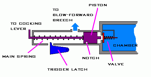

edit: I'm liking the idea of an externally cocked hammer, as an simplified adaptation of the design proposed here, what about this?
I'm back at work already so the furious rate of prototype production will probably subside somewhat, at the same time I'm also conteplating hammer valves as well as revisiting the preloaded cartridge idea - I still want to see that spent brass fly one day
- externalhammer.gif (4.63 KiB) Viewed 4557 times

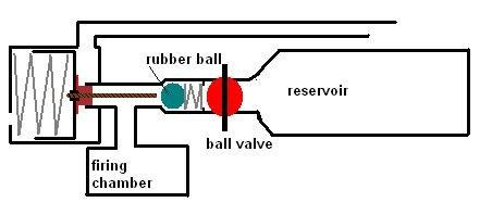

Here's my version of the smash-up of Rag +Hotwired's ideas:
Does that look right? (I know I left out the action/loader, too lazy). I think it would work, although the length of that threaded rod will need to be tuned just right (shouldn't be too hard, just run it in or out of the piston using the nuts.) Also, probably want something more convenient than a ballvalve, maybe with some flow restriction.
With this, the 'poke-open' valve will necessarily be opening just before the piston seats (since it's a seat-seal, not a sliding seal), so there is a chance that this could hang. That could be solved by switching some things up and making a sliding seal there, but that would increase the complexity and difficulty of manufacture.
That looks about right, what I don't like however is that air is released the moment the piston moves back. Personally I would modify it slightly like so:
