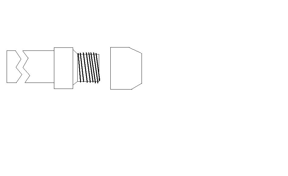

well mathematically 1.5mm should be right yes but i don't see any harm in making the piston travel a bit bigger something in the region of 5mm i would use. and if you want to make the piston serviceable then just use threaded fittings :)

the threaded caps ive seen thread into something smaler than the barrel like this:
