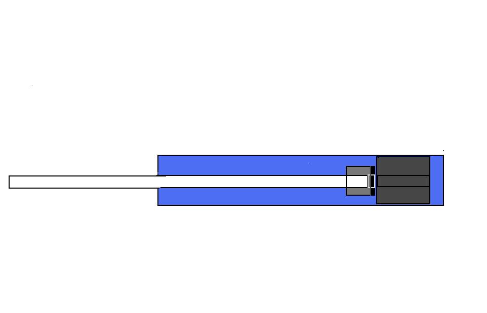

Can I make an epoxy plug for the barrel then drill a hole to fit the barrel the just put neoprene on the barrel seal and skip adding it to the piston?
Like this:

Tue Mar 11, 2008 9:25 pm
ya that would work too. But depending on how wide the rubber is (skinnier is better) everything (neoprene, and piston) has to be very flat to make a seal. If it wasn't flat, it would make a seal at high pressures but when you're filling it with a bike pump, at the start it might leak. On 3/4" cal barrel, I would just attach the neoprene to the piston. It's just easier.
Tue Mar 11, 2008 10:45 pm
You need a secure way to attach the rubber to the barrel though. I find that automotive rubber hose is excellent for this application and comes in a variety of sizes.

I am not using a 3/4" barrel.. The chamber will be either an 1" or 3/4, the barrel will be more like 6-10 mm. I don't believe I could find a washer for that size.. I may bring the barrel to 1/2.. I am not sure. I will go to home depot this weekend and see what they have. And the lighter gray layer in my picture is an epoxy cylinder that will have the neoprene, So my question still stands, Would I have to add neoprene on the piston if I go by my diagram.
Thu Mar 13, 2008 1:03 am
If you have neoprene on the end of the barrel then you don't need it on the piston.
