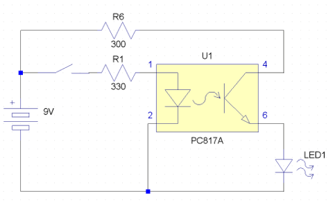

The attached circuit should test the MOC.Insomniac wrote: What would be a simple test (on one of my spare MOC's that hasn't seen the 300V of the trigger cap) that would verify it was working? I could try that, then connect it to the flash, then disconnect it and test again. This would let me see if the voltage or current that the trigger cap can deliver was damaging it.
I wonder if the problem is the leakage current of the triac? Diodes leak current even when they are "off" or reverse biased. IIRC, the leakage current is usually in the tens of microamps. The data sheet for the MOC3020 says the reverse current (I<sub>R</sub>) is "0.05 to 100uA".
The charging circuit for the flash trigger is 300V through a 1 Meg (?) resistor so the charging current to the trigger cap is at most 300/1e6=300uA. Perhaps there is enough leakage through the triac so that the trigger cap isn't getting fully charged?
The circuit diagram you are working from is probably for a much more serious flash unit with a more powerful supply to charge the trigger cap. With the circuit all wired up do you get the same voltage across the trigger cap as you do with the photoflash board disconnected from the MOC?
- The two reistors can probably be anything from 300 to 600 ohms. The LED should light when the switch is closed and stay lit until the battery is disconnected. (I don't have the schematic symbol for the triac optocoupler so i used one for a phototransistor.)
- MOC_tester.gif (10.86 KiB) Viewed 2546 times
Hmmm... I might go and buy some prototyping breadboard and then I'll test your circuit.
prototyping boards are very useful. Buy one with a power bus. Also get a jumper wire set, makes things much easier.
Hmm... bought a prototyping board/jumper wire kit, and have used a meter and jumper wires to work out how it's all arranged inside. Pretty simple once you get used to it. Tried that circuit you posted... and the LED didn't light when I closed the switch (the blue jumper at the top of the circuit is acting as a switch)
Wait a sec... while posting this I had a stroke of genious and remembered the two far-away pins are 1 and 3... not 1 and 2. Just moved a jumper wire one hole and it now works.
Now I know a brand new MOC works, I'm gonna switch it with one we had been using in our failed trigger. (Hah, I'm writing this as I go so It's like a running commantary
Ok, did that... and my little yellow FLED is blinking happily away. So the MOC isn't being fried by my other circuit... yet the trigger circuit fails to work. Hmmmmm..... electronics is intreiguing and a bit frustrating.
Btw, here's a pic of my proto-board and the test circuit (note that in this pic I have the long red jumper going to the wrong leg on the MOC... I've fixed that)
