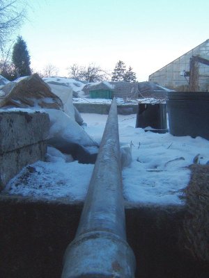

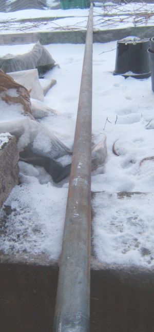

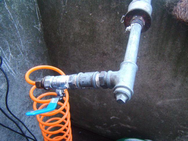

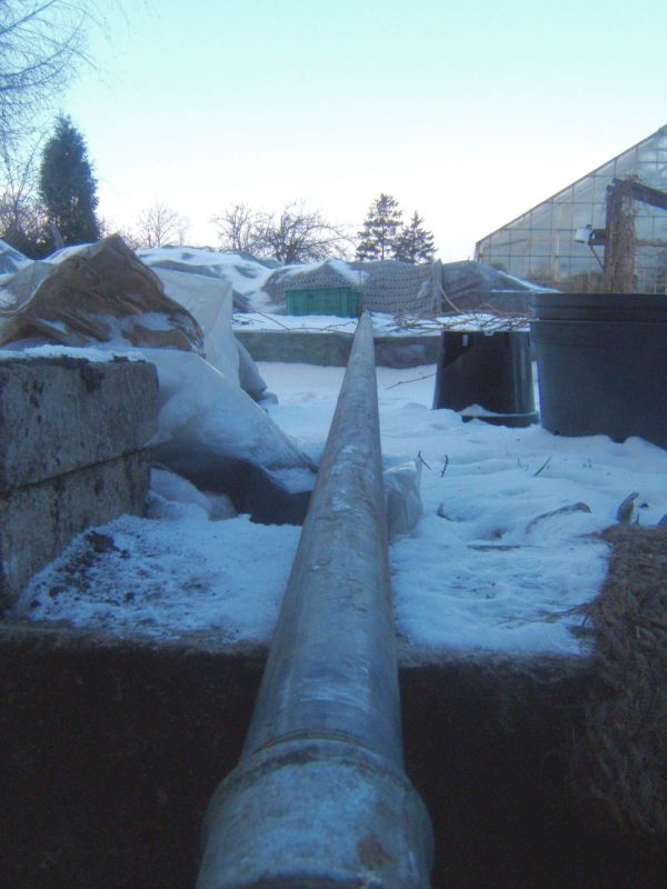

I finally had time to add an air tank... it's made form 7 meters of 1.5" steel pipe LOL that's high tech isn't it ?? :wink:
should be relatively safe to use at up to 400 psi
the tank capacity is about 10 L (note that 1.5" is a nominal size of the pipe - the real ID of the pipe is ~ 4.4 cm, not 3.81 cm.... for example a 1/2" pipe has an ID of ~1.4 etc.)
now the funny thing is that it takes 9 minutes to fill it to 100 psi, which is much faster than it should :?:
well now I have more than I need for a high pressure BBMG or to test my semi

Ok, how exactly did you fit this 7 meters of pipe inside your house, not to mention attached to your pump? Did you just spiral it, or something?
I have been wanting to make a chamber for my pump, so could you post a pic?

of course I keep it outside... I have several pipes just lying around so I thought - why not to turn one into an air tank...
if you have some as well go for it - it took me 0.5 hour to build it including threading the pipe.. if you don't it might be a better idea to get a CO2 tank or fire extinguisher or an old scuba tank as this is far from being portable
I'll add pics tommorow... not that there is much to show... basically it's just a long pipe with an endcap one one end and several reductions and spare fittings that I had on the other...
it's joined to the compressor by an airline, which is supposed to act as a safety measure - an inexpensive burst disk in case something goes wrong...

Tue Feb 17, 2009 1:24 pm
pics... well not much to show here - it's very simple
today I've filled it to 400 psi...

Tue Feb 17, 2009 6:26 pm
Lol! That is huge... Not exactly portable, but it sure holds a lot of air...
