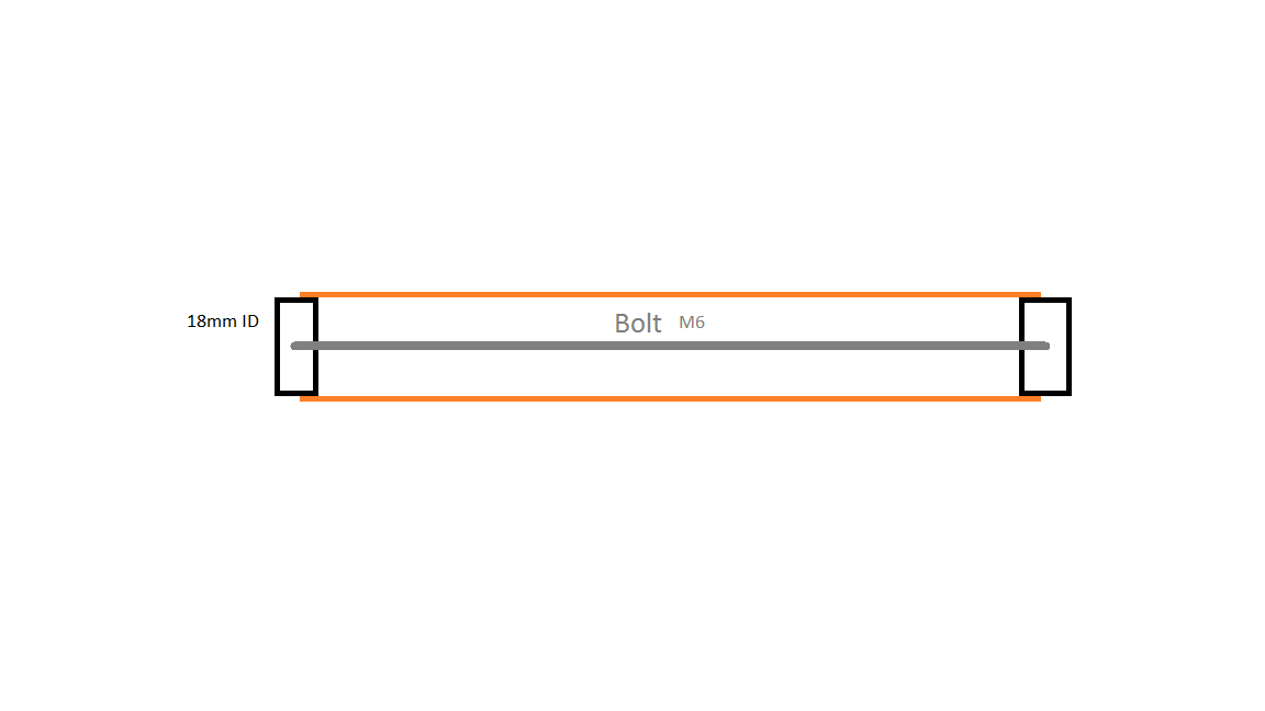

I'm using a single M6 bolt to secure both ends of a chamber, planed to be filled up to 3000 PSI. Bolt material is unknown but it's some kind of steel (standard steel bolt with zinc to prevent rust I think). Will hydro-test it to 4500 PSI but I'd like some opinions. I'm very bad at drilling holes or making threads so I'm hoping this is a way to make PCP chambers.
From these online calculators I found a M6 screw should work for 3000 PSI, 4500 PSI would be a bit too much. The chamber is 2mm walled 304 SS seamless tube. The bolt has at least 15mm thread into the end caps.
