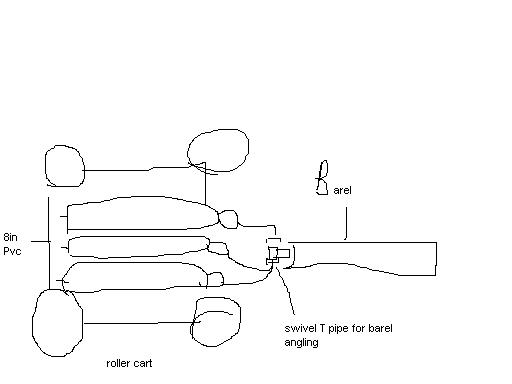

I soon will start on my latest cannon, my third. I've been thinking about it for a few days and have figured it out. It will consist of a 15 foot piece of 8inch Schedule 40 PVC cut in to three 5 foot lengths. They will be placed side by side in a roller cart. Each will be capped on one end with a schrater valve. On the other end will be a automatic modded sprinkler valve. After the valve on each the pipes will connect and form something like a _ _|_ _
so one pipe on one side, 2 connect on the other, and they go to a T pipe that is not glued in, so the barell that goes into it can move at a free 180 degrees.
It will have multiple barrel attachments ( not quite sure how to do that yet) and the 3 inch barelle will be 15-20ft long.
The reason for 3 pieces of the 8 inch pipe instead of one long piece is to allow me to either fire 1 shot withall the power, or 3 seperate shots at a 1/3 of the power.
The total chamber size will be about 8000cu in
Luckily i found a great irigation store that sells all this for real cheap, plus they give me the contractors discount which is 30% off!
I've included a drawing to give an idea of what it will look like.
Sorry how bad it is, im no artist

Construction of Monster Cannon

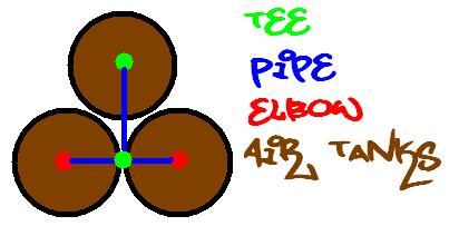

When you said your going to attach schrader valve to the ends I assume that you plan on pumping it up with a bike pump (manual/ electric) If so thats not going to work very well when you have to fill up that much area so I would suggest a air compressor if you planned other wise. If you end up building it you defintly need to post videos and pictures. If I may suggest I would recomend that you arrange the air tanks like in the picture below and then have the barrel a straight shot out of the top tank with a tee to connect it to the bottom two tanks. I think it would just look cooler arranged this way (no practical use behind design besides that it might be more compact)

Hi, thanks for replying with some feedback. Yah that design works good to, ill have to try both once i get the parts and see which is easier to make, im trying to be as cheap as possible but still having a great cannon.
