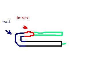

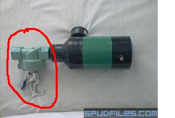

you dont "have" to but it will make the setup alot easier(you wont need a huge ass project box with switches and battereys). and it will increase performance drasticly. when i modded the valve for my latest gun, it took me about 15 minutes to actually mod it and 6.50 to by the parts
if you know what i mean by that.....
use a valve like this and just attach it with a u to the chamber
the setup i suggest
the setup i suggest

What advantages does using an inline valve have over one that would be the U itself?
drac
Posts: 899
Location: Avon, NY
Fri Dec 23, 2005 8:38 pm
The 180 degree valves with the Anti Siphon slightly choke flow. And don't use a "U". Use 90 degree elbows, most Us aren't pressure rated.
