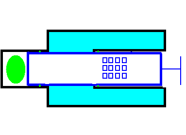

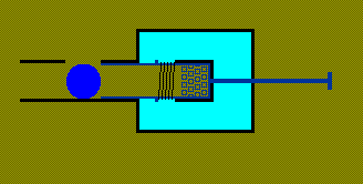

I may have seen this somewhere else but I have an idea for it. The pin that sticks out the back could be used with a trigger to hold it back and release it, or with gatling style bolt action, honestly I think it would be cool to have a true potato gatling gun, not like the one that claims to be one but is just 6 guns strapped together and doesn't even rotate. The trigger operated version could use a manual bolt or something like what is used in electric airsoft guns. This basically runs like any standard bolt, it doesn't need a piston which is why I mainly like it, and can be used in rapidfire. The spring pushes the bolt forward when released allowing the air from the chamber to enter the holes in th bolt.

That should work, but it would need O-rings and it might be difficult to get a seal on the pin but the idea is sound. I created a picture of basically this design with a little change, I made it so that the pin doesn't pass through the chamber. (the green dots are O-rings and the light blue is the pressurized chamber)

Wed Mar 01, 2006 7:03 am
So the barrel acts as the piston and slides in the chamber? Straighten me out on this idea please.

Wed Mar 01, 2006 11:56 am
No, the barrel and the chamber are both fixed. There is a bolt that is not fixed and seals against the barrel and a piece of pipe in the chamber. This allows for the bolt to be moved forward so it no longer seals against the peice of pipe and exposes venting holes that then allow air into the barrel.
