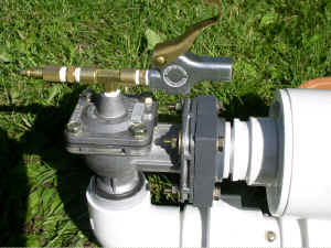

Quick exhaust valves are different than sprinkler valves. They open faster (that's why they are called quick exhaust valves). But they also cost a lot more and are harder to find (they usually have to be bought online).[/i]

Shrimphead
Posts: 509
Joined: Thu Nov 17, 2005 7:42 pm
Thu Mar 02, 2006 7:48 pm
Nope. That is just a piston valve. Quick Exhuast Valves are manufactured by companies such as Goyen.
This is a qev with a blowgun on it for actuation.
