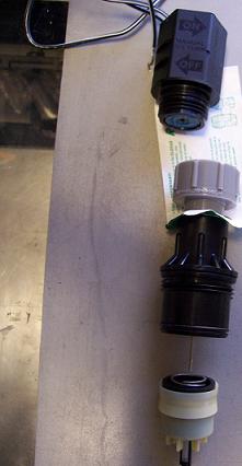

To know where to mod a valve requires opening it to see if it had a guide rod or not and to see where the spring sits. Open it up and if you still don't know where to mod it, then post a pic of the opened valve.

Hey, you posted as I edited. I did open up the valve, and have a picture of it if you'd like. It does have a guide rod and I see the spring, but I am not sure where on the side to put the tap. So here we go.

thats the same valve I bought orriginally.I couldent ever get it to work.I returned it and got a watermaster.those valves are alot more complicated than the watermaster,and there is a ton wore to go wrong
