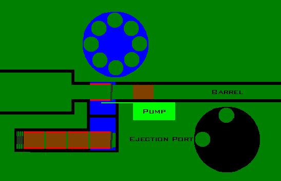

I have found a way to update the standard revolver. The disk rotates to line up with the slide which pushes a shell into the slot. Each slot has a small spring in it. The disk rotates up to the barrel, and fires, the disk rotates the now empty shell towards the ejection port where the small springs pushes the shell out of the disk. There is a splate to keep it from ejecting early, (Hard to draw) with gaps for the barrel and ejection port. The pump rotates it like these designs.

Pump Revolver
- Pump Revolver.JPG (16.07 KiB) Viewed 2130 times
- This is a simple bolt loader with a pump handle for round ammo.

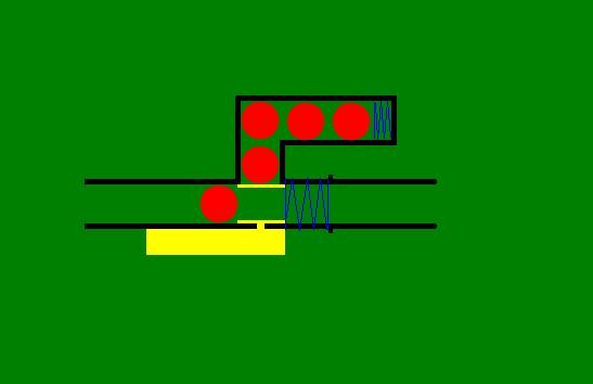

- Ball Pump.JPG (9.39 KiB) Viewed 2132 times

Thank you, now does anybody have anything to say about my idea? Rigt now I'm working on a pump-action like a traditional shotgun, tubular magazine.

Revolver:
I see no reason to have more than 3 starage spaces in the revolving drum.
I think you'll have trouble sealing the cartrige/barrel and cartrige/chamber junction. You might be able to use face O-rings (like in a union) on the chamber and barrel, and latch it down by moving the barrel with a cam or something.
"shotgun"
I think you'll have ammo "flow" problems within the magazien at the bend.
Making the turn more gentle would be an option, although then you have a few shots you can't expell from the magazein. More practical might be simply releasing the spring pressure for a moment during the pump cycle.

Don't forget that it will have an elbow which is curved, it's only squared in the drawing. I basically took the revolver and gave it an automatic reloader. Infinite revolver.
