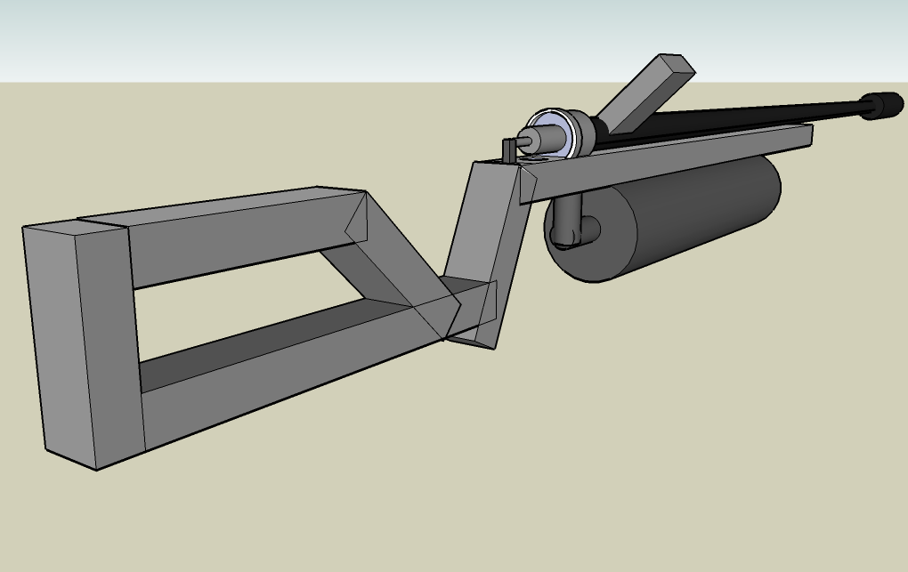

wow I got a lot to learn
my google sketch up models are,....well it gives the idea what it something is goning to look like but that's all
- pellet gun model.png (32.96 KiB) Viewed 89359 times
