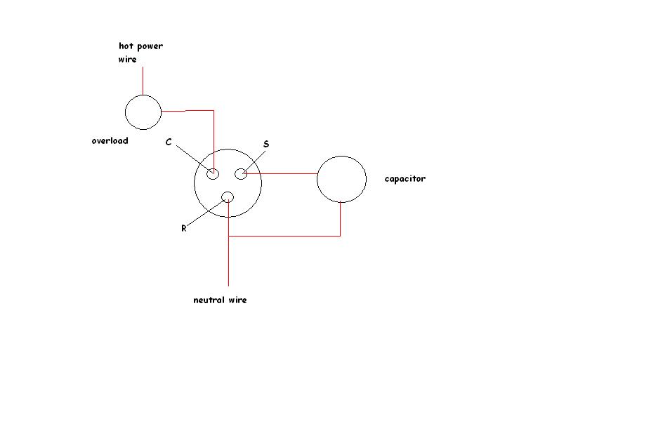

I'm a visual person, so is this how it should be properly hooked up? The red lines are wires.

Yes, that thing, in the new pic above, with the wire is the overload. On the opposite side of it should be a dark disk that is recessed a little. That is the side that should rest directly on the compressor. As a matter of fact there should of been a small spring that fits around it while it's through the rubber piece. When you put the cover on, the spring pushes it so it stays in place. There should have been some paperwork with it which has the reccomended capacitor. ex. 25mfd @ 370volts. I should be like a small silver tin can with two terminals on top. Like this...
http://americanhvacparts.com/Merchant2/ ... Single.jpg
By the way, your drawing is correct.
