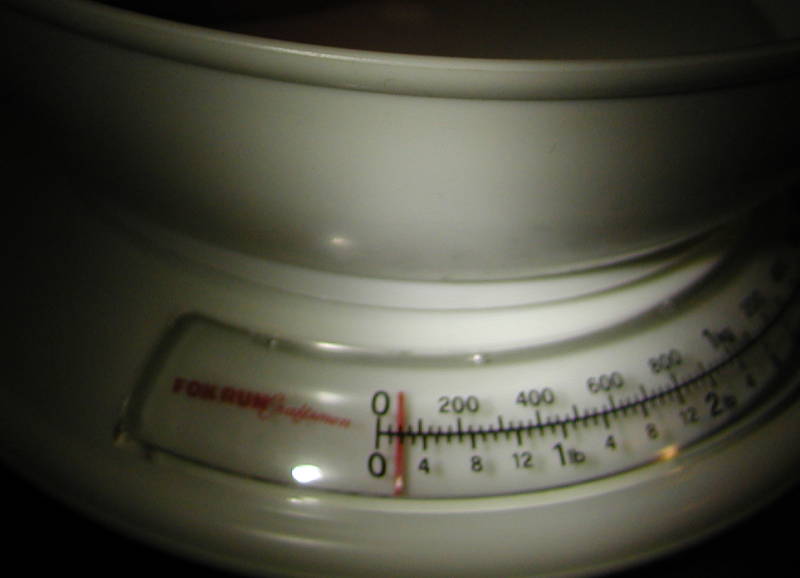

Update, I found some scales an weighed the Poof brand foam ball. In modeling without weighing it, I came up with about 60 grams in GGDT.. The actual weight is right at 2 oz. Since 1 oz is 1 ounce = 28.3495231 Grams according to Google this is pretty close. I do have the coef shown in the GGDT model above at subsonic speeds.
- Poof foam ball on scale.
- Poof on scale.jpg (27.12 KiB) Viewed 3431 times
It's applied to any valve: BS piston, CS piston, burst, hammer...Technician1002 wrote:It's the assumed transition through the burst disk with remains of burst disk at the edges of the flow.
It's not specific to burst discs. Anyway, I'm not talking about the valve, I'm talking about the barrel.
Yes, but I seriously question the logic of modelling it as one. Quick opening though it may be, it will not be burst disk quick.In testing I was surprised that my valve seems to beat a burst disk in flow.
It'll be a modest amount quicker than a regular piston valve, and barely any difference compared to my TARDIS valves.
If we're being that specific, why not go the next couple of decimals?Since 1 oz is 1 ounce = 28.3495231 Grams according to Google
1 ounce = 28.349523125 grams, exactly by the definition of the BIPM (International Bureau of Weights and Measures).
And the worrying thing is, I know these numbers off the top of my head (don't even ask about the time I memorised Pi to 100 decimal places)
