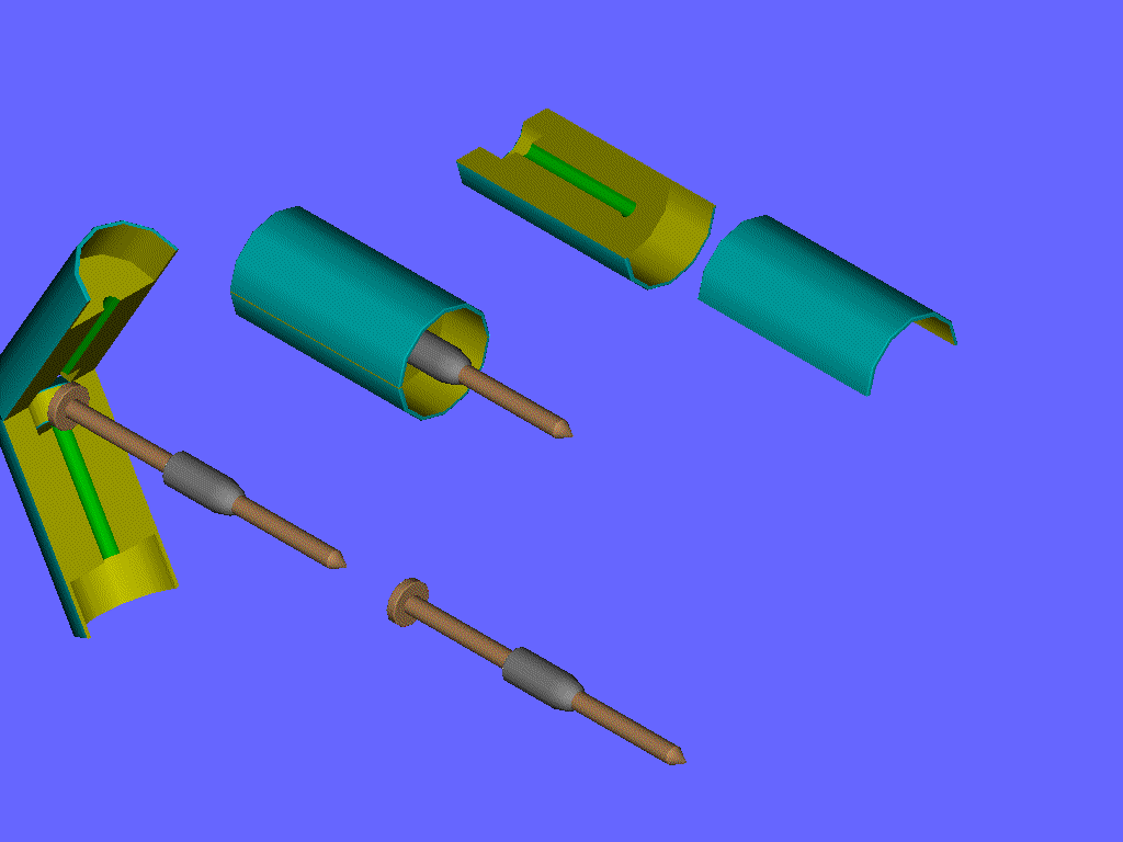

Here is a concept drawing I made for BoytonStu.
It is a 2.5 inch serrated nail with a bullet sinker and a discarding sabot for a copper 3/4 inch barrel type M with ID of .811 inches nominal.
The sinker is used to insure a front heavy attitude for flight stability.
Click to enlarge.
Click to enlarge.

Very nice. Should the tail of the round (nail head) be supported to reduce forces on the lead? I could see the sabot and lead launching and leaving the nail behind if the lead slips.

Tech;
Yes the sinker needs to have a wire soldered in the front and epoxied from the rear once the ideal stability point is found.
I chose a bullet sinker so the center of gravity can be fine tuned by sliding
it forward of center of pressure for the optimum stability.
It is just drawn for some body to build and try.

I'd put the sinker more on the front. And +1 on the fins. However, a piece of duct-tape or rope will also work.

The rear seal could be either an o-ring or a flexible flat disk attached near the back of the sabot. I initially considered drawing that it but decided to leave out. I will update the model to show a seal.
