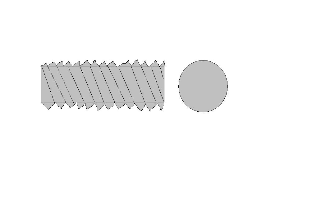

It would be making a threaded tit of 3/4 inch, but with a steal rod(i mean a plumbing pipe but not hollow), so i would be getting a tit, like a plumbing pipe one would, but not hollow, it would be full of steel.
Little paint here;
(i need that to then, after drill holes of right size in it)
Can it be made(with a threading machine) ?
Sun Nov 08, 2009 6:13 pm
if you're asking if it's possible to thread a rod then the answer is yes
'cone shaped' threads are called tappered threads
Demon
Posts: 743
Joined: Sun Apr 13, 2008 8:46 am
Mon Nov 09, 2009 9:34 am
Yea, but with npt threads, but not tappered...
Not shure if it can be done.
Mon Nov 09, 2009 10:18 am
NPT is tapered (also notice the spelling I made a typo in my last post)
http://en.wikipedia.org/wiki/National_pipe_thread
so it's best if you use BSPP
http://en.wikipedia.org/wiki/British_st ... ipe_thread
but you might as well use NPT... you might experience some problems with sealing it if you thread it all the way but it should mate
