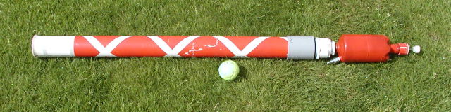

A small chamber at higher pressure works well and takes little time to fill with a bike pump.
A large chamber takes lots of time to get the pressure up but at lower pressure, the noise is much less at the same range. A large chamber with a longer barrel and large valve can launch tennis balls nearly 500 feet at about 80 PSI.
- Small chamber and fast valve gives this a couple hundred feet of range. It's a little noisy with the small barrel at higher pressures.
- Tennis ball barrel1.jpg (36.58 KiB) Viewed 5785 times

YES! thank you
I was looking for something just like this, very simple and efficient. nailed it
Couple comments on that photo.....
-what is the total length of the gun, and if it is large could I collapse the barrel down (thread off), or make it shorter because I dont need it to go a mile (simple right)
- for loading>>i've seen a kinda drop in loading in guns from the barrel- than covered up by a trap door-- is this possible?
and below I found a totally portable cordless battery powered air compressor -- nice gun-like design for actual trigger >>> not sure of quality 39$ )))))))))link:
urlhttp://www.google.com/products/catalog?q=cordl ... ellers/url
-------> any plans for this red gun in the picture??? link???
