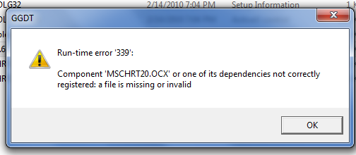

Why can't I run GGDT?
It gives me this message.
I run Windows 7.

Try a Google search for mschrt20.ocx site:spudfiles.com . There's a solution floating around.
