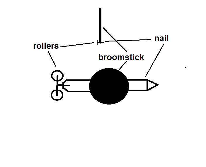

edit: how about something like a rifiling tool (nail on a broomstick) but with an ajustable stopper and a rollers on the back of the nail to keep the groove straight
