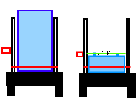

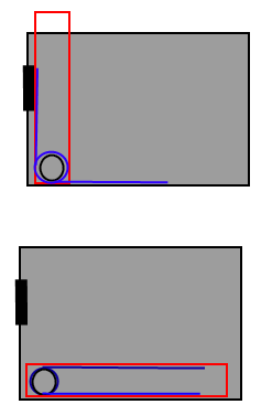

i have looked at your plan and come up with a little something.
you have to close it by hand, and when you do a little rod (green) will move into a hole and will be held there via spring pressure. the actual iron sight (blue/red) is under spring pressure at this point as well.
when you press the button, the green rod is pressed inward, losing its hold on the wall, and allowing the whole sight to move upwards into its operating position.
what do you think?
locking mech, open close (front view)
locking mech.png (9.31 KiB) Viewed 3513 times
open and close, side view
open close.png (6.24 KiB) Viewed 3513 times

Needs some fine tuning but it could work.. I'll try to give it a shot once I get my hands on some walnut. Thanks
I'd like to point out to just one thing. The whole purpose of BUIS is to have iron sights folded so they dont get in the way of the primary aiming device - a scope in my case. The way you drew it looks like it has no height difference compared to a normal static iron sight when folded. You want those walls to be at the same height as the folded aiming aperture :D

Thu May 27, 2010 4:40 pm
well if you want to point things out... There is no actual sight, its just a box right now. It was just a pre concept design. You could probable make it a bit shoeter and get rid of half of the case wall, that would make it shorter.
