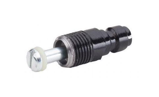

I'll agree with Heimo and Chinnerz. I've seen some brass quick connects for compressors...these could be used with a tire valve core (cleaned of rubber of course) and simply sweated together.
A good and easily workable solution to having a check valve on the "launcher".
But have you considered doing something like this?
ninja mini fill.jpg (11.97 KiB) Viewed 3526 times
