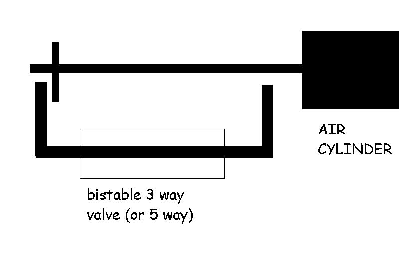

it is possible to build a fully mechanical system, but it isn't as simple as you think.... the valve has to switch not only when the air cylinder extends but also switch back when it returns to the original position... it sounds more complicated than it really is - pic included for clarity
- Fmechanical.JPG (23.59 KiB) Viewed 2001 times
haha polandspud, thats exactly what Im trying to do with this design, the switch is bistable. But there are two contacts on the cylinders rod instead of the on the switch.

ohh ok... in theory it is simple but it will be a bit tricky to put everything together since both parts are usually attached to the opposite sides of the QEV
The pneumatic system is better in this respect and it is adjustable, but it requires an air piloted valve and a flow restricting valve...
On the other hand, the mechanical system will achieve the highest ROF possible.
The disadvantage is that it triggers the gun not when the max pressure is reached but when the air cylinder reaches a given position (but it don't think this will be a problem on a gun this size.... most likely the pressure will reach the maximum before the air cylinder extends fully (due to inertia))
