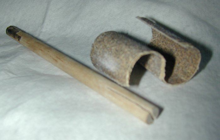

So, I fell back on an old method of sanding inside a pipe.
Get a suitable sized dowel rod.
You can use an old bolt, if you wish. It'd last longer, and be stronger. It'd just be more difficult to cut than a dowel.
Cut a slit in the end of the dowel.
Cut a suitable sized piece of sandpaper.

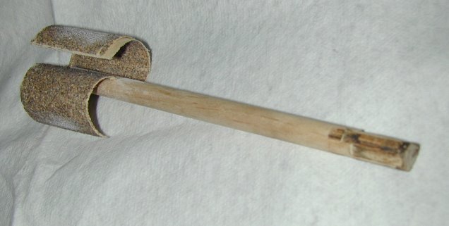

Fold the sandpaper so that the grit is on both outsides.
Slide into the slit, in the end of the dowel.
Now chuck the other end of the dowel up in your drill, and hawg away !!
Using a knife, files, a rolled up piece of sandpaper, etc... The sort of hand tools I had around... It would have taken me at least an hour to hog out the inside of that fitting.
Using the 'flapper-hawg', it took me roughly three minutes to get it suitably hogged out.
Note: It is easier to work with, if you make the shaft, (dowel rod), only as long as you really need. If you make the shaft too long, it will flex.

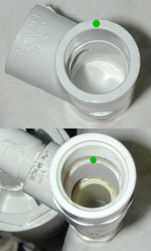

I already glued up the tee. So the comparison picture will be a bit difficult.jrrdw wrote:No picture of the finished piece? Would like to see how this tool did...
Here it is.
Note that the finished tee is already glued inside a 3/4" female fitting.
So, I put a green dot on roughly the same spot on the lip of the two tees.
Now look down toward the hole in the left side, on both tees.
The ridge that you see above the hole on the intact tee, is the same thickness as the 'stop ridge' on all 1/2" fittings. Only, the entire 'pipe' is that size from that point, to where it becomes the 'stop ridge' on the other side of the tee.
In the finished fitting, the entire region of the tee has been hogged out. A 1/2" pipe will slide completely through the tee.
I hope this helps.

- Top: New tee.
Bottom: Finished 'valve body'. - compare.jpg (23.93 KiB) Viewed 5854 times
