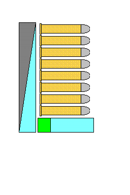

I agree springs are a perfectly good solution already. High-strength magnets are very fragile and also lose power at temperatures above 175 F.
Whereas springs are tough, light, and depending on the alloy can probably still be workable at over 500F.
A magnetic mag spring would probably be built something like the picture below, where gray=iron, blue=plastic, and green=magnet.
The magnet assembly (green/blue rectangle) would of course ride in grooves in the magazine's walls to keep it level, and may need some grease to cut down on friction.

I am almost sure it works like this.
I think the lowermost magnet is fixed in the mag, and the rod is fixed to the topmost magnet. You can see that the rod moved into the mag while shooting.
And I don't think that your design would work Fnord, not even with a very strong magnet.
But as the others, I don't see a significant advantage of using a magnet spring.
