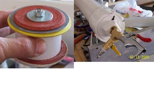

Well I built a 'Spudzooka' yesterday and waited till this AM to test....
hooked up air....Nothing..... RATS !!
I have the 'modified diaphram' design I found on a site - basically 2 diamphrams srewed on each end of a small PVC coupling - like a 'diaphram piston' I made the metal disks and gaskets on my little lathe so its pretty precise I guess.....
I have nop idea whats wrong =(

Here are the pics...
What do you mean equalization hole ?? My piston seals against the barrel fine... it leaks a TINY bit sometimes but you cant tell unless you tape plastic over the barrel end-then it fills up and pops it

- toms-spud.jpg (16.84 KiB) Viewed 9521 times
I am filling it with a compressor - I have a 5HP in my garage.....
I also have a pressure gauge mounted on the air chamber at the reducer end - it fills up and registers nicely.....
I tried it at 40, 60, 80, 100 PSI nothing- It seals up FAST, holds air - hit trigeer.... nothing but air comin out the trigger.

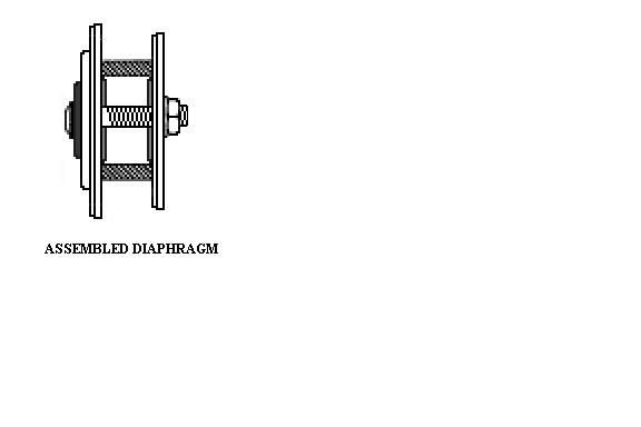

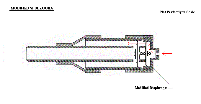

Here is the link I found details on how to make this type gun
http://home.comcast.net/~glenshindel/Sp ... o_page.htm
If ya scroll down there is a cool annimated gif and the details I posted above

I'm not an expert on pistons and such but after looking at that animation you see how when it's filled air goes around the sides of the barrel? Then when the blowgun is triggered that air is the air that pushes the piston open to fire...
I don't think yours is filling up around the barrel.
How fast does it fill up when you fill it?

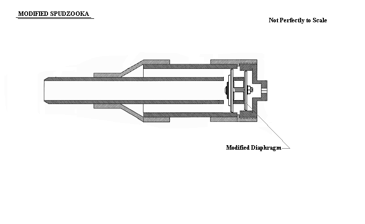

Yeah, I have a strong feeling you are only filling your pilot chamber.
Ypu need to drill/cut a hole int the piston, leading from the pilot chamber to the main chamber. DO NOT make a hole leading to the barrel, this would make the spud come out of the barrel as soon as the compressore is hooked up, and land about 5 feet away. Hold up, I will make a pic, just to make sure you get it.
The arrows are the path of the air (pretend the piston is sealed)
The hole should be about 1/8th inch.
- Equalization hole
- equi_hole.GIF (22.66 KiB) Viewed 9425 times
