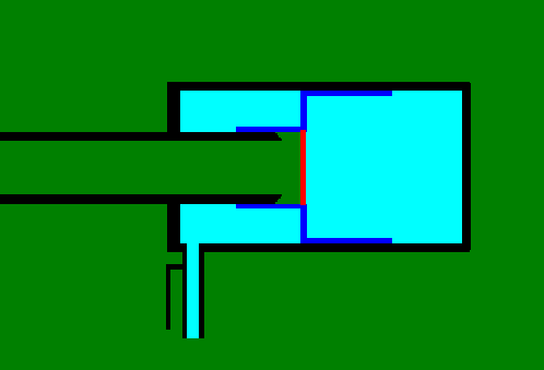

In this design, the burst disk is built into a piston which moves forward towards the sharpened, serrated barrel when the pilot chamber is vented. When the burst disk hits the barrel it breaks releasing all the air behind the piston to go through the piston and into the barrel. This gives you a triggering mechanism to fire on command.
P.S. Please don't say "It would be easier just to use a burst disk"

and how do you expect to replace the burst disk each time?
the only way i could see you doing it effectively would be with a screw on endcap...which really isnt pressure rated...

They make pressure rated, threaded caps, they are basically female encaps that screw onto male adapters.

Atlantis your first design is really good... all you have to do is keep adding air until the burst disk is pierced then it vents instantly down the barrel, causing the diaphragm to go back, letting more air down, causing lots of air to rush down the barrel very fast, causing great power.

Frogy i believe he is using a trigger mechanism where the preassure is the same on both sides of the piston and he vents the front half andit moves forward piercing the disk.
I like the idea atlantis and i wouldnt mind having to unscrew and replace the burst disk everytime besides the flow and power of this valve would be amazing.Good job i might design something like this and use hyrdogen see how fast you can get a projectile.

I hope I get a chance to build this, I'm gonna try to make a homemade union that will better fit this concept. I plan on using one of my current 1.5" barrels.
