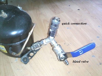

jsefcik wrote:
Do you need a bleed valve ? Does lowes carry them?
Yes I need them, because in high pressure, quick connections are difficult to disconnect and very loud if you did that. With a bleed valve, after the chamber is full, close the chamber valve, then open the bleed valve to let the rest of pressured air that are left in the compressor and fittings out, so you can disconnect it safely :)
my compressor
my compressor
