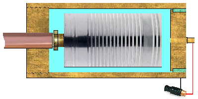

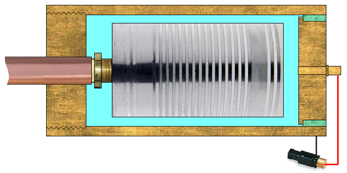

Followingthis revelationby D_Hall (which I'm sure will shortly be unlocked) I wonder if it could be applied in a practical manner by those without access to silly quantities of C4.
Here's a concept, using a screw capped tin or maybe a PET bottle, full of light gas attached to a barrel with a burst disk in between, all housed inside a hybrid chamber...
Recently at work I hooked up a 55 gallon drum to a vacuum pump to prove a point, the result looked a little something like this - if you can get that collapse wit ha few psi difference, well...
No plans to actually build this, but there seems to be some merit to those looking for high supersonic velocities without solid propellants.

Interesting concept, but it seems pretty flawed. There will be a lot of energy wasted deforming the inner chamber, and the inner chamber won't fully crumple, effectively creating a lot of dead space. Plus, there's a lot of surface area to cool the combustion gasses, which can't be good. Admittedly, the inner chamber, if heated, would still transfer that heat energy into the projectile's acceleration, so I'm not sure if this would be detrimental to the performance.
I think this is a design that really does require silly amounts of special chemicals to be practical.
Posts: 26179
Has thanked: 543 times
Been thanked: 321 times
Sun Aug 28, 2011 4:03 am
Insomniac wrote:Interesting concept, but it seems pretty flawed. There will be a lot of energy wasted deforming the inner chamber, and the inner chamber won't fully crumple, effectively creating a lot of dead space.
In the case of a hybrid driven launcher, a piston is probably a better idea.
That's what I was thinking, hot pressurised helium... which could also be pre-pressurised to compensate for the dead space.
As I said, no intention of building it, but an interesting option to put out there.
