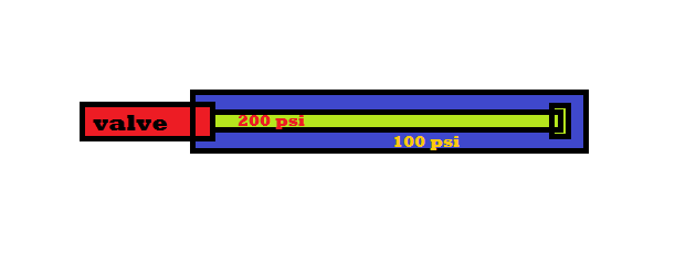

I've always had this idea in my head to make pvc take higher pressure.
Basically there is a larger diameter pipe around the inner chamber. The outer chamber is pressurized to whatever pressure, say 100 psi. This makes inward force on the inner chamber, so in theory, twice as much pressure than the outer chamber can be added to the inner chamber. Does this sound right?

That'd work, though I see not the purpose of such a construction. Just get something with a higher yield strengthGun Freak wrote:pvcpressurevessel.png

... apart from the fact that should the jacket leak, you've created a "triggered burst disk" style thing.saefroch wrote:That'd work, though I see not the purpose of such a construction.

Correct, but I don't honestly expect anyone to build that...
