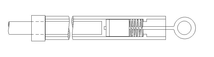

I came up with this yesterday. Its a manually operated barrel sealing valve. Its still a bit on the complicated side though. Any thoughts?
The manual barrel sealing face valve. In Between the two discontinued pieces would be a Tee fitting.

I like that idea,
but you would need to use like 20 psi or if you want to go higher, then
you need a stronger spring.

Is the small pipe the barrel or the chamber? It might not work as a chamber.
Jakal444
Posts: 111
Joined: Sun Jan 29, 2006 1:12 pm
Fri Jun 30, 2006 1:15 am
Benny, like the original post said, i will probably be using it at 20 PSI.
Spudstuff. The smaller pipe is the barrel. The chamber is not shown in the rendering.

I like that design. Will there be pressure behind the piston too? Because if there is it's going to be a challenge making the sliding part not leak but still slide.

DJT you don't make sense, a sliding part that doesn't leak would be hard to make? It's just a coaxial piston without a pilot valve and instead a strong spring and the pistons pulled back by hand...
It'll be easy to make leakproof, just mold a piston out of hot glue and stick O-rings on it...

It looks like you pull the piston away from the barrel by hand with that bar with a circle on it. I said it would be hard to seal the bar that slides if the part behind the piston holds pressure. Now that I look at it I dont think it does though.
