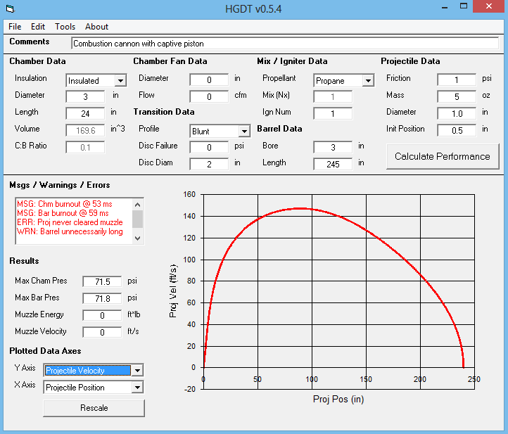

Have a look at the HGDT model attached. As you can see, a peak velocity of 145 fps is reached, but the projectile then slows down and stops in the barrel. If the projectile consisted of fullbore sabot and sub-caliber projectile, then the sabot would stop but the projectile would carry on.
You can see the effect of having a large barrel and small chamber clearly here:
Of course, the example I showed has a 20 foot long barrel, hardly practical - but you can create the equivalent space with a sleeve around the barrel. Putting a 10 inch diameter sleeve on it would mean that you could get away with a two foot barrel.
