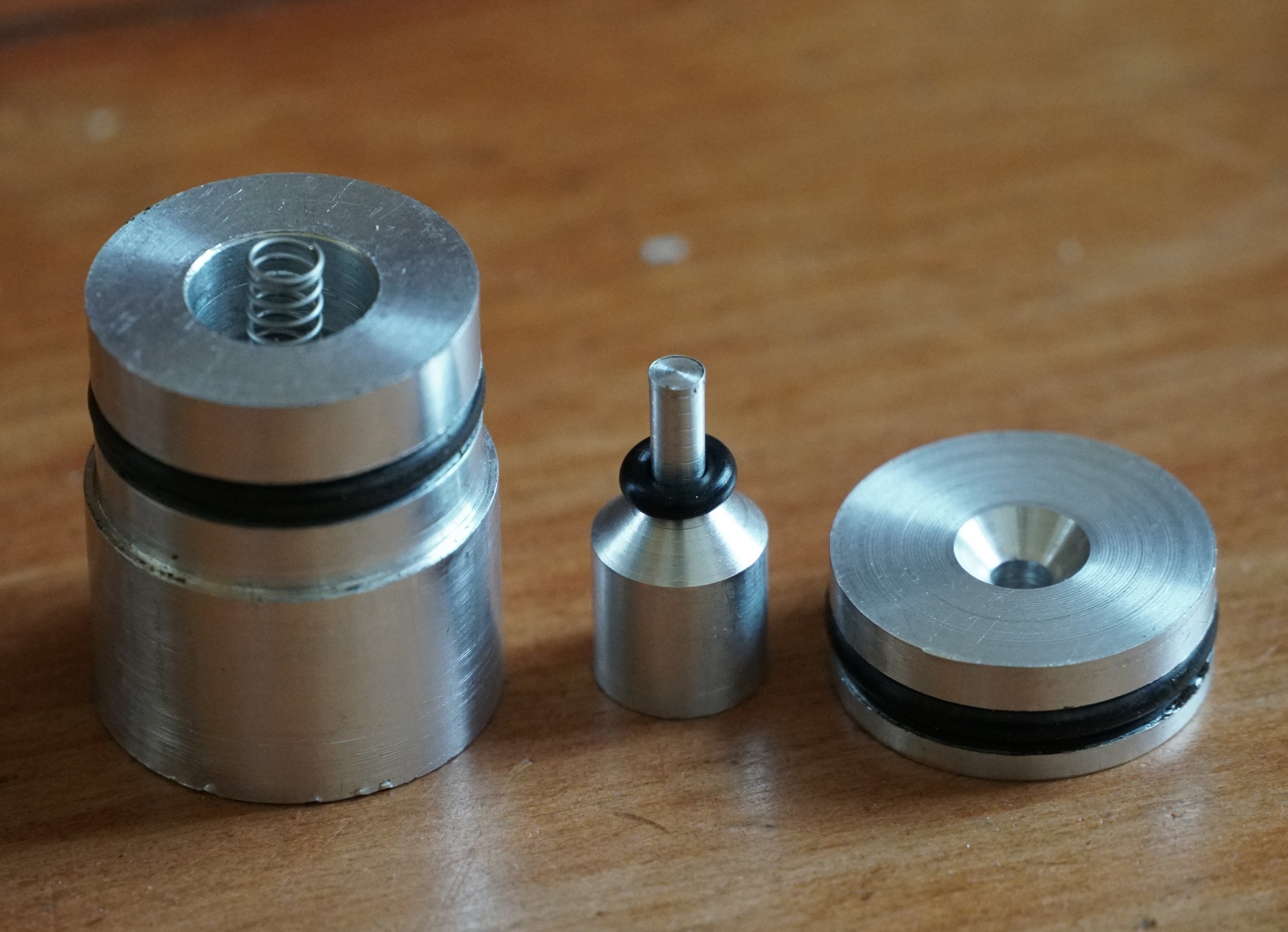

Exploded view of check valve internal components.

The ridge half way up the left part is not required, it was used to position the top surface of the checkvalve half way through the 20mm fitting.
