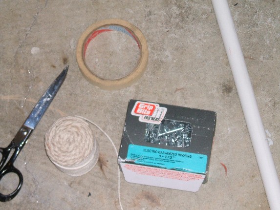

All the materials
All the materials

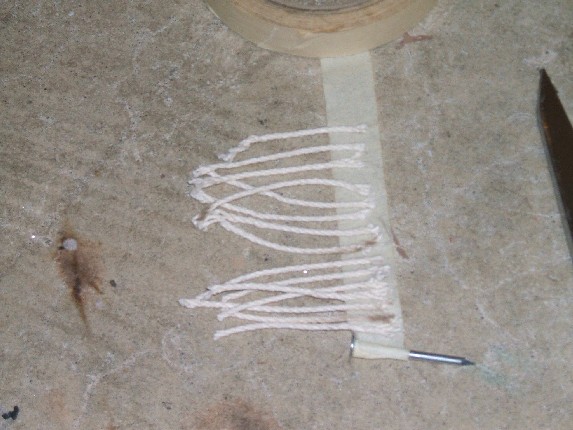

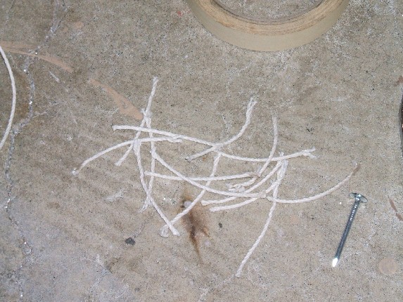

Cut about 15 pieces of string 2" long and a 5 inch long piece of tape
Line up the string on the tape, along with the nail

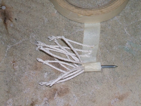

Roll it slowly, keeping the tape flush with the nail's head

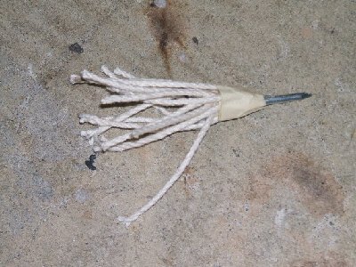

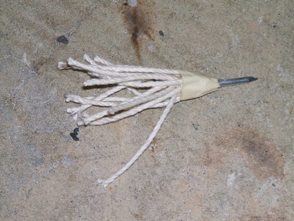

The finished dart
The finished dart

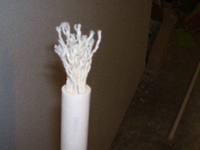

Put the end in the blowgun
Push it down about 3/4," so string doesn't go in your mouth

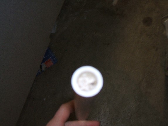

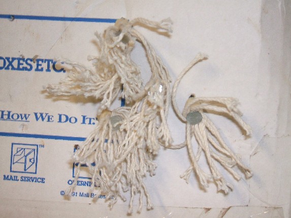

All of these darts were shot, not stuck into the box

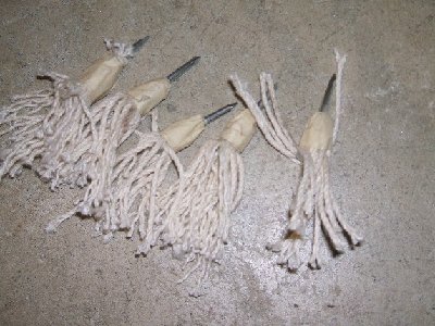

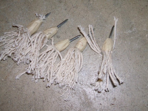

A few darts
A few darts
